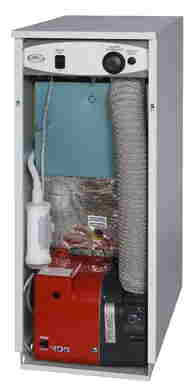

Increase roof insulation. About a third of heat loss can go through the ceiling. Where possible, increasing the thickness of insulation to 270 mm (11 inches) is recommended, and if this is not possible you should certainly have at least 100 mm (4 inches). If you have less than 100 mm, increasing it can give the most rapid return on your investment. Add a jacket to the hot water cylinder if it does not have a foam outer coating. At least 75 mm (3 inches) and preferably more is recommended. This is cheap, easy, and pays for itself within months. Fit cavity-wall insulation. Install a condensing boiler. If your current boiler is over 10 years old, this should reduce fuel usage by perhaps 35%. All new boilers must now be condensing models. There is more information on boilers and heating below. Add automatic heating controls. Room thermostats (especially programmable ones), hot-water cylinder thermostats, timer/programmers, and thermostatic radiator valves are all useful, saving energy while increasing comfort. Fit double glazing or secondary glazing. This halves heat loss through windows, reduces condensation and noise, and is more comfortable. However, for saving energy it is not as cost-effective as the other suggestions. There is more information on windows below. Get a free energy check A simple, free check that suggests what you can do to improve your home and how much it might save is offered by the Energy Saving Trust. Condensing boilers and heating
Modern boilers are lighter, so less metal has to be heated up when they are turned on; this is more efficient especially in summer when the boiler might be used intermittently to heat water. All new boilers, both gas and oil, must now be condensing boilers, which further increases efficiency by extracting the heat from the steam generated in combustion. The efficiency of these reaches about 91%, compared to perhaps 78% or less for elderly boilers. Condensing boilers collect heat from the flue gases and use it to pre-heat the water returning to the boiler. If the difference between the flow and return temperatures is too low, little benefit is gained from the preheat, so the difference is controlled automatically by adjusting the water flow and heat input. Condensing boilers gain most energy from condensing the steam in the flue gases if the water being drawn into the boiler starts cool. With higher input water temperature, more steam will escape as vapour and less energy will be captured through condensation. Efficiency begins to drop above about 40°C, and falls off rapidly if the input water temperature exceeds 50°C. A generous area of radiators helps to cool the water before it returns to the boiler. A lower output water temperature also results in a lower input temperature, and this can still provide the heat needed if the radiator area is large enough
Heating water with a gas or oil boiler in summer should be more efficient than using an electric immersion heater, because electricity costs several times more than gas or oil for the same energy. A boiler and the pipework connecting it to the hot water tank would need to be very inefficient for it to be more expensive for water heating than an immersion heater. Combi boilers (left) are a good option for smaller properties. They drive the central heating system and also supply hot water directly, avoiding the need for a hot water tank and the associated heat losses. As the water is heated only when it is required, the flow available is more limited than from a hot water tank. Underfloor heating allows condensing boilers to run at high efficiency, as it provides both the desirable features of a low temperature heat output and a large radiating area. It can be combined with conventional radiators and hot water heating by using a separate control device that can ensure that the water used in underfloor heating is at about 45°C rather than the 80°C needed by normal radiators. Each method of heating has its relative benefits and disadvantages. Underfloor heating keeps walls free of radiators, but is not compatible with thick carpets. A pane of glass conducts heat easily, so windows with single panes can lose 10 to 20 times as much heat as the same area of wall. A house with single-pane windows might lose a quarter of all the heat generated through its windows. Reducing the heat lost by windows is thus a significant issue. Most solutions to reduce heat loss also provide better sound insulation. The simplest method to reduce heat loss through windows is to provide another layer of insulation, for example by using curtains. Closing curtains at night makes a significant difference provided they are of reasonably thick material. Blinds, however, make relatively little difference.
