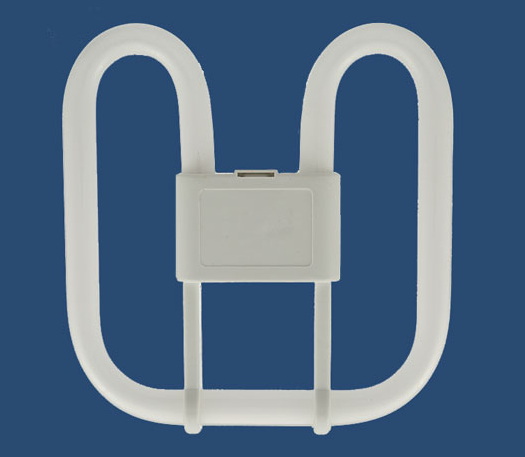

Because of the peaky spectrum of light generated, colours viewed under fluorescent light often differ from their colours in daylight – in particular reds can look darker. Tubes with three phosphors (triphosphor) have better colour rendition as well as typically being brighter. In domestic use, many houses use fluorescent tubes in kitchens, utility rooms, garages and bathrooms. They are used much less often in living rooms, bedrooms, etc. as fluorescent light and fittings often seem colder and more ‘industrial’ – using warm white tubes can help with this. Ultraviolet lamps omit the phosphor and transmit the ultraviolet radiation directly. They are used for disinfection chambers and sun beds. Black-light fluorescents convert the original ultraviolet light into the near ultraviolet, which can then generate strange theatrical effects when shined on paints and other materials which fluoresce in visible colours. This section discusses the traditional fluorescent tubes that have been available for many years (two photos at left, below) as well as improved modern varieties (two photos at right), while low-energy bulbs (properly called compact fluorescents) are treated separately in the next section. The important distinction is that compact low-energy bulbs work in the same fittings as incandescents, while other fluorescents need dedicated fittings. Efficiency The main advantages of fluorescent lights over ordinary or halogen incandescent lamps are that they generate much more visible light for the same input energy, last much longer, and their surface is much cooler. A rough rule is that they use only about a quarter as much energy as incandescents to produce the same amount of light. However, the light output often depends on the colour balance – the cooler mixes tend to be more efficient than the redder ones, so for example a white tube will usually produce more light than a warm white one of the same wattage. However, there are slightly more expensive triphosphor warm white variants (e.g. GE Polylux XLR) that do produce more light as well as claiming improved lifetime. It is also worth noting that it can take a fluorescent a few moments to come up to full intensity, especially in a cold environment, and that the light output drops by about 20% over the life of the tube. The typical lifetime is usually stated to be about 10,000 hours, with some tubes claiming 15,000 or even 30,000 hours, but this depends on how often the tube is switched on and off – sometimes a life of 50,000 on/off cycles is claimed. The oldest types of fluorescent tubes have been phased out under EU legislation, replaced by compatible tubes with more efficient phosphors. These can reduce power consumption by about 10%. It is also possible to replace a conventional starter with an inexpensive electronic plug-in canister (e.g. Philips Power Saver Set). Combined with more efficient tubes, the consumption is then reduced by about 30%.
Fittings and types Fluorescents require extra equipment in addition to the tube. In older-style fittings a starter heats electrodes at each end and then opens the circuit. This triggers a spike of voltage to start the plasma, which often flickers on and off a few times before becoming continuous. A magnetic ballast (consisting of an inductor) assists in generating the initial spike, and then limits the current in the tube, which otherwise would become excessive after the plasma has been created. Such fittings sometimes flicker and hum in an irritating way at 100 Hz, especially as they age. The light can cause moving machinery to appear stationary. The EU is phasing out this older type of fitting. Modern fittings have electronic ballasts with no separate starter, and operate at higher frequency (e.g. 25,000 Hz). The light comes on instantly without flickering, and annoying hum and flicker are less of a problem. Electronic ballasts can be designed to support dimming of fluorescents, keeping the filament hot while reducing the current across the tube. However for this to work there must be a good match between the dimming control and the tube. Some lights with integral ballast have been developed to provide dimming in conjunction with incandescent dimmers. The flickering of some old-style fluorescent fittings disturbed some people, causing migraines and sometimes triggering epileptic fits. This should be better with the modern fittings. Despite some claims, evidence that this is still a problem is sparse. Conventional fluorescent tubes come in a variety of lengths and diameters. The main types, based on tube diameter, are:
A standard fluorescent tube costs from about £3. For example, a 58-watt tube (often used in kitchens or utility rooms) might cost £5, with a warm white version offering more light output and longer lifetime for £6. Labels must indicate how much light they produce, in lumens. More unusual designs can cost up to perhaps £15. Wherever possible use newer high-efficiency triphosphor types for more light and better colour rendition while using the same or less energy. The range of tubes and fittings in DIY or electrical shops tends to be quite limited, but a list of online suppliers is given below. A limited range of direct replacements for fluorescent tubes that are based on LEDs are becoming available. These have all the advantages mentioned in the LED section, but at present are expensive to buy. Recent developments In recent years a number of more compact and efficient designs using different tube configurations have appeared (examples are shown in the right-hand two photos above). Sometimes confusingly called compact fluorescents, these differ from the low-energy bulbs (CFLs) described below because, like traditional fluorescents, they do not include a ballast in the tubes and so cannot be used in incandescent-type fittings. Some of these have four pins and others only two; the ones with two pins have built-in starters. Examples are shown in the two pictures at right. Often used in low-energy light fittings, they are required by some UK building regulations to prevent use of incandescent replacements There are ceiling lights that use several parallel, shorter tubes in recessed reflector fittings that are designed to maximise light output to the room. These are mainly designed for public buildings and offices (typically with false ceilings) rather than domestic use. However, some newer wall-mounted designs are quite acceptable for domestic living areas. These use fairly short tubes, sometimes bent to form an extended closed shape, as in the picture, and placed behind a glass or plastic diffuser. These fittings produce a lot of light and lie fairly flat on the wall; they are on sale in DIY and electrical shops. End of life Fluorescent tubes contain some mercury (less than they used to) and so require special treatment, available at local waste disposal centres. Do not put them in with your normal rubbish. If you break a fluorescent tube, ventilate the room well before cleaning it up to avoid inhaling mercury vapour. Conclusion * Fluorescent tubes are a very effective way to reduce

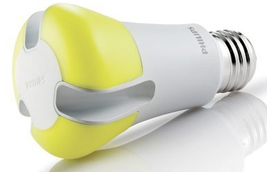

Passing current through special types of semiconductor diodes generates light. The colour generated depends on the materials making up the diode. For many years red, yellow and green LEDs have been used as indicator lights, or for simple alphabetic or numeric displays. LEDs can be shaped, for example to produce the widely used 7-segment numeric displays in digital clocks. The invention of blue and then ultraviolet LEDs led to the production of white LEDs. White-ish light is generated either by combining diodes using different materials, or by coating a diode generating ultraviolet with a suitable phosphor. The operating voltage across the diode is only about 1 volt, which means that battery operation is an attractive option. Another attractive feature is that they last far longer than ordinary lighting, with lifetimes claimed to be 50,000 hours or more. This makes them useful for reducing failures and maintenance, especially in safety-critical applications or in places that are difficult to access. For example, arrays of LEDs are now used for traffic lights, some car lights, etc. LEDs come on at full intensity, in contrast to CFLs. Although they are easy to dim in principle, many models do not allow this – if you want dimmable LEDs, check the packaging carefully before you buy them. They will also be somewhat more expensive than standard non-dimmable LEDs. Efficiency The light emitted by one diode is not very bright (though that is improving), but several diodes can be combined to make a light that is more compact and uses much less electrical energy than an incandescent bulb. Arrays of many diodes are fabricated using some of the same large-scale production techniques used for electronics. The light is emitted directionally, unlike domestic light bulbs, but that is a useful feature for many of the current applications such as torches, or replacements for halogen spotlights (photo at right) such as those widely used in kitchens and bathrooms. The efficiency of the brightest LEDs has been increasing steadily. Even at fairly low efficiencies (comparable to incandescents) they have the advantages of low-voltage operation and long life, and so have been in widespread use as indicator and illumination signs for quite some time. More recently, they have become widely used for compact, light-weight portable devices such as torches and bicycle lights because even small, low-power batteries produce sufficient light and last a very long time. LED lighting is under very active development. Efficiency is now comparable to or better than fluorescents or low-energy light bulbs, which means they generate very little heat. For the future it is generally expected that LEDs will become even more efficient, but in order to achieve this a problem called ‘LED droop’ has to be solved – this is a reduction in light output efficiency as the electrical current carried by the LED increases. Higher efficiency and improved production methods are steadily reducing the present relatively high prices of LED lights.
Fittings and types LED lighting for domestic use is still evolving rapidly, and new types and applications keep appearing. Some of the ‘white’ LED lights on sale still have the cold, blue-ish colour balance of early LEDs, but warm white lights are now widely available. The most common are replacements for halogen spotlight arrays. There are direct equivalents for mains-voltage bulbs (e.g. GU10, photo at left above). For low-voltage bulbs (e.g. MR16) it is also necessary to replace the small transformers used for the halogen bulbs with ‘drivers’ (photo of MR16 bulb and driver module at centre). However, if a large number of bulbs is being replaced it may be cheaper and more efficient to install a single low-voltage power supply for the entire room. The type of driver or power supply needed may be different if you wish to dim the bulbs. What wattage is needed is not always clear, since different brands make very different claims about light output. Although the output in lumens given on the package is helpful, care is needed in comparing directional bulbs if their output covers different angles. If you are replacing a number of halogen bulbs it is a good idea to try one or two LED equivalents first in order to check that they give out the desired amount of light and that the colour balance (warm white usually preferred) is acceptable. Small LED-based reading lamps are becoming more common. Strips of LEDs to provide concealed background lighting are available. Overcoming the directionality of LEDs is difficult, but good replacements for ordinary, omni-directional light bulbs are now on the market, though beware that they often do not emit much light towards their base. (Photo at right above is of a 60-watt bulb replacement that won a US Dept. of Energy prize). However, bulbs equivalent to more than about 60–80 watt incandescents are not yet available and prices are high. Replacements for fluorescent tubes are also available, though again very expensive, and note that they tend to be directional. The price of LEDs is still high. Although the savings due to their high efficiency and very long lives are considerable, the up-front cost of replacing a substantial number of lights (e.g. halogen spotlights) in many houses is considerable, and the cost of the newer omni-directional bulbs and fluorescent tube replacements is even higher. However, prices are dropping steadily. LED lighting has huge potential in the future. Producers predict that efficiencies two or three times better than fluorescent lights seem possible. When this is combined with ways to produce diffused light to fill a room, there is a possibility of a true revolution in lighting since arrays of LEDs need not come in the form of bulky bulbs or tubes. Rooms might be lit by large-area flat panels or interesting shapes. End of life Light-emitting diode lights would generally be classified with other electronic goods, and should be brought to local waste recycling centres. Conclusion * Light-emitting diodes are the future. They are already the best choice for directional lighting, replacing halogen spotlights, and some omni-directional models would be a good choice. However, more development is needed to produce omni-directional lamps with higher outputs and reduce their cost before they can become a complete solution for general domestic lighting. Manufacturers These are some of the main companies producing low-energy lamps, with links to their websites: GE
